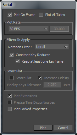

In the Facial dialog that appears, select the plotting options you want to use.
Facial plotting dialog
Select one of the two plotting options in the Facial dialog box:
Option Function Plot on Frame Activate Plot On Frame to resample the data based on the specified frame rate, and ensure that data is plotted on exact frames. Keyframes are set on each frame of the animation. This is the default setting. Plot All Takes Activate Plot All Takes to plot the data from all takes to a selected model. Plot all takes to your model if you intend to export the animation to other software.
