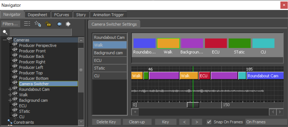

The Camera switcher is a window that lets you switch between the custom cameras placed in your scene so you can create a take using multiple camera angles. It is found in the Scene browser’s Cameras folder after the seven Producer cameras, and before any Custom cameras.
The Camera switcher contains the custom cameras you have created. If you have no custom cameras created in your scene, the Camera switcher is empty.
Switches created in the Camera switcher can be converted for usage in the Story window’s Edit Track list.
The Camera switcher is divided into three parts, the camera pane, the camera colors and the switcher timeline.
