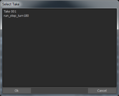

Change Take
The .fbx files you use as animation, character and camera animation clips can contain more than one take. The clip uses only one of the takes by default. The Change Take option opens a dialog box, which lets you select a different take for the clip.
Select Take dialog box

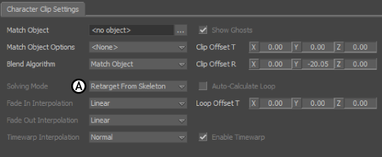

The Solving Mode menu, which displays in the Asset Settings window, lets you see which solving mode a character clip is using. If Retarget From Skeleton is selected, the clip can only be made writable if you plot the animation to the current skeleton. When Skeleton or Control Rig is selected in the menu, the clip can be made read-only.
Asset Settings window A. Solving Mode menu

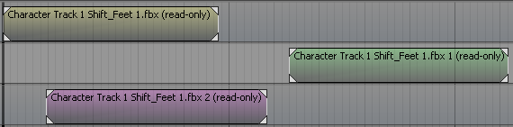

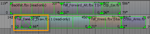

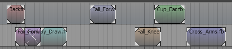

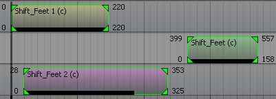

While inserting a current take, you can duplicate the resulting clip multiple times with different clip timings. In the following figure, the Shift_Feet (writeable) clip is duplicated twice with different clip timings.
The following two options in this sub-menu allow you to convert all writeable clips on the Story tool to read-only:
  • Default Name — Displays the Open Directory window. Choose a folder to save all the converted read-only clips using their default names.
  • Customized Name — Displays the Save Clip window. In the File Name text box, enter a custom name to save all read-only clips.

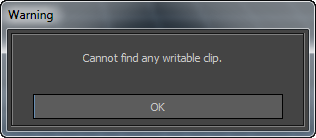

Note:
If there are no writeable clips available on the Story tool, then selecting the Default Name or the Customized Name option displays the following error message.
MotionBuilder converts all three clips to read-only.
While converting, MotionBuilder identifies that the two duplicated clips are references of the Shift_Feet clip. Therefore, the resultant read-only file is a single "Character Track 1 Shift_Feet 1.fbx" file. Converting multiple clips to a single read-only file saves the system memory.

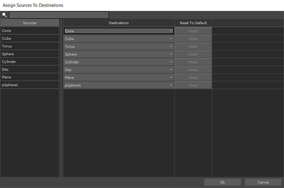

Assign Sources To Destinations
The selected assets in a track and the track’s clips are linked automatically. The Assign Sources To Destinations option opens a dialog box which lets you view and change these links.
The Assign Sources To Destinations option is active when you right-click animation, camera animation, and character clips.
Through the Assign Sources to Destinations dialog, you have the option to search for sources in a clip. Simply click on the search bar in the top left corner and type in the source you're looking for. This is especially helpful when clips contain hundreds of objects.
Assign Sources To Destinations dialog box

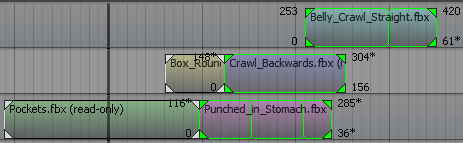

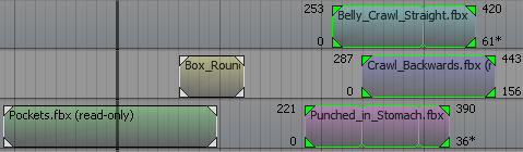

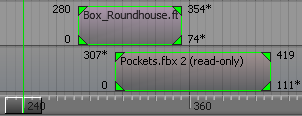

Aligns one or more selected clips with the previous clips on the same track.Note: This option does not have an impact on the selected clip that do not have a previous clip on its track.
In the following figure, notice that the position of Box_Roundhouse.fbx clip does not change because it does not have a previous clip on its track.
BeforeAfter

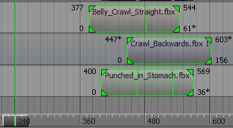

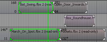

Previous Clip (All)
Aligns one or more selected clips with the position of the selected clip's previous clip.
For example, in the following figure, three clips on track 1, 2, and 3 are selected. Right-click Pockets.fbx clip on track 3 and choose Align To > Previous Clip (All). The Pockets.fbx clip aligns with its previous clip on track 3, and the other two clips on tracks 1 and 2 align with reference to the Pockets.fbx clip's previous clip.

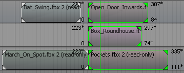

Next Clip
Aligns one or more selected clips with the next clip on the same track.Note: Similar to the Previous Clip option, this option does not have an impact on the selected clips that do not have a next clip on its track.

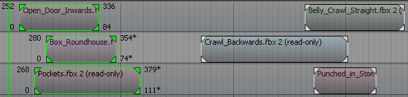

Next Clip (All)
Aligns one or more selected clips with reference to the position of the selected clip's next clip.
For example, in the following figure, three clips on track 1, 2, and 3 are selected. Right-click Pockets.fbx clip on track 3 and choose Align To > Next Clip (All). The Pockets.fbx clip aligns with its next clip on track 3, and the other two clips on tracks 1 and 2 align with reference to the Pockets.fbx clip's next clip.

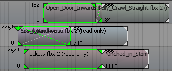

If you select multiple clips in different tracks, then all other clips, except the right-clicked clip offset to the distance of the right-clicked clip to the Timeline indicator.
For example, in the following figure, three clips are selected. Right-click the Punched_in_Stomach.fbx clip, and choose Align To > Current Time (Offset). The Punched_in_Stomach.fbx clip offsets to the Timeline indicator (from frame 400 to 240). The other two clips also offset 160 frames toward the Timeline indicator.
