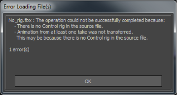

No Control rig in the source file
If the Replace Control Rig option is active, but there is no Control rig in the source file, the following error message appears:
To correct this problem, disable the Replace Control Rig option, or make sure there is a Control rig in the source file you select, then try again.

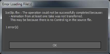

Animation was not transferred
This message can appear for one or more of the following reasons:
  • The plot operation failed, because there is no character in the source file.
  • There was no character in the source file.
  • There was no Control rig in the source file.
  • There was no character in the current scene.
  • There was no Control rig in the current scene.
  • The Control rig in the source file was not connected to the Control rig in the current scene. Either there is no character in the source file, or there is another problem.
    Error Loading Files dialog box: Animation was not transferred
