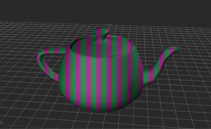

Projective textures cause strange effects when used on three-dimensional objects, as they do not recognize the object’s shape so much as project directly onto the front of it.
In the following figure, note how the striped texture does not recognize the curve of the teapot's lid, bowl, spout, or handle
Teapot model with Projective texture
