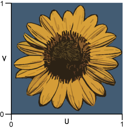

    The Scaling Pivot Offset U and V values range from 0 to 1.00. Change the value of the Scaling Pivot Offset.u property to move the pivot along the width of the texture. Change the value of the Scaling Pivot Offset.v property to move the pivot along the height of the texture.
    A texture’s U and V values range from 0 to 1.
    To scale a texture from its center, for example, enter a value of 0.50 for both U and V properties, placing the texture’s scale pivot in the middle of the texture.

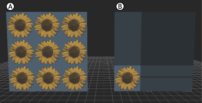

  7. Select Repeat in both U Tile and V Tile menus to let your texture tile in both directions. Otherwise, select Clamp from either menu.
    Note:
    If both U Tile and V Tile menus are set to clamp, your texture will not tile.
    Same texture on two planes, with Scaling set to 3. A. Texture set to U and V Repeat B. Texture set to U and V Clamp
