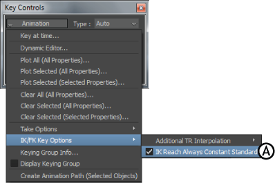

IK/FK Key Options menu
The IK/FK Key Options menu lets you select preferences pertaining to setting IK and FK keyframes. You can choose either Additional TR Interpolation option or IK Reach Always Constant Standard option.

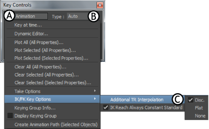

When you choose Additional TR Interpolation option, the results depend on the interpolation type selected in the Type menu of the Key Controls.
Key Controls A. Animation menu B. Type menu C. Additional TR Interpolation option
For a description of the results you can achieve with Additional TR Interpolation options when Auto and TCB interpolation are selected in the Type menu, refer to the following tables.
Use the Additional TR Interpolation Discontinuity option with the following interpolation types.
Additional TR Interpolation: Discontinuity (Disc.) | |
Interpolation Type | Description |
Auto | Auto interpolation with discontinuous tangents. |
Fixed | Fixed interpolation with discontinuous tangents. |
TCB | TCB interpolation with Continuity set to a value of -1. |
These options do not affect Stepped or Linear interpolation.
Use the Additional TR Interpolation Flat option with the following interpolation types.
Additional TR Interpolation: Flat | |
Auto and Fixed | Fixed interpolation with flat tangents. |
TCB | TCB interpolation with Tension set to a value of 1. |
Use the Additional TR Interpolation None option with the following interpolation type.
Additional TR Interpolation: None | |
Auto, Fixed and TCB | Interpolation with tangents that are neither flat nor discontinuous. The interpolation reflects what is selected in the Type menu only. |

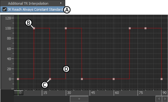

The IK Reach Always Constant Standard option lets you choose whether the interpolation is Stepped Step or Stepped Step Next.
Key Controls A. IK Reach Always Constant Standard
When you set an IK or FK keyframe, Translation, Rotation, and Reach properties are keyframed. The interpolation set for Reach is always Stepped.
When the IK Reach Always Constant Standard option is active, any IK or FK keyframe you set always has Stepped Step interpolation for Reach properties. This option is active by default.
Function curve for Reach T property in FCurves window A. Active IK Reach Always Constant Standard B. IK keyframes show a value of 100 C. FK keyframes show a value of 0 D. All Stepped interpolation is always Stepped Step

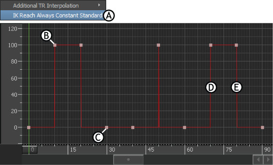

When the IK Reach Always Constant Standard option is disabled, the FK keyframes you set have Stepped Step interpolation for Reach properties, but IK keyframes have Stepped Step Next interpolation.
Function curve for Reach T property in FCurves window A. Disabled IK Reach Always Constant Standard B. IK keyframes show a value of 100 C. FK keyframes show a value of 0 D. Interpolation for FK keyframes is Stepped Step E. Interpolation for IK keyframes is Stepped Step Next

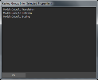

Keying Group Info option
The Keying Group Info option opens the Keying Group Info dialog box, which displays information about the keyframes that are part of the selected keying mode.
