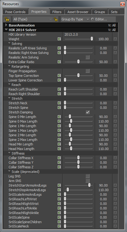

To display and access the HIK 2014 Solver properties:
  1. In the Navigator window, expand the Characters folder and click the HIK 2014 Solver that is nested beneath your character.
    Note:
    You can also expand the Solver folder in the Navigator window and click the solver.
  2. In the Resources window, select the Properties tab.
  3. In the Properties, right-click in an empty area and choose Expand All.
    The properties of the selected solver are displayed.
