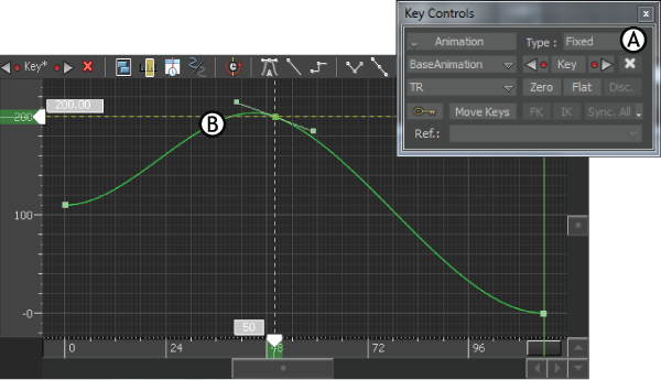

Angle settings
The Angle settings allow you to edit the angles of a selected tangent in a keyframe, using degrees. The angle of left and right tangents are unaffected by previous and next keyframes when tangents are edited, and become fixed.
Note:
Angle settings are visible only when the Stepped, Linear, or Fixed tangent mode is active.
A. Fixed interpolation selected B. Selected tangent of keyframe’shown to be offset by 20 degrees
