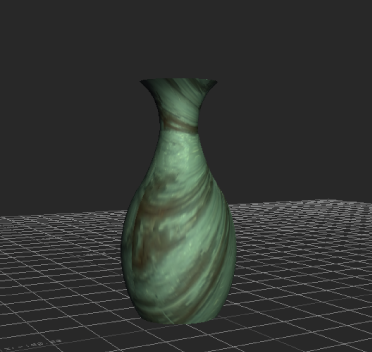

Some of the effects of materials, such as detail and reflectivity, can be also achieved with shaders or textures. Used together these can give simple grey models surfaces which resemble glass, metal, skin, and so on.
Vase with materials, textures, and shaders added
A model’s material properties may be used by the texture settings when applying textures, and by the shader settings when applying certain shaders.
