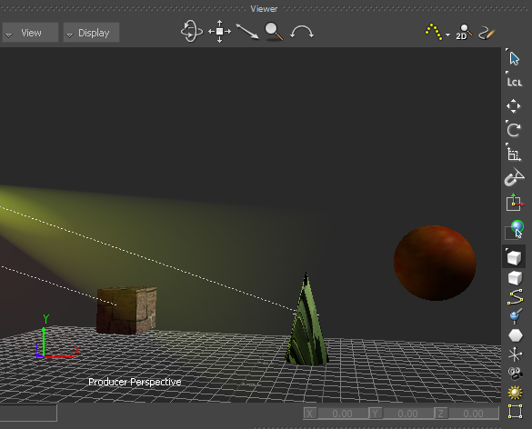

The Viewer window Reference mode tools lets you select between Global, Local, and Additive Reference modes. The Additive Reference mode tool is only available when you are in Rotation mode.
Reference modes affect how the translation, rotation, and scaling values of an object are displayed. See Object global, local and additive reference modes.

  1. Click the Reference mode icon .
  2. Select one of the four modes.
