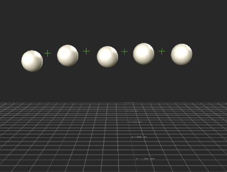

  1. Create a group of spheres in a row in the Viewer window.
    A row of spheres
  2. From the Asset browser Elements folder, double-click the Null asset, and then click between the beads in the Viewer window. Do this between each bead and press Enter when you finish.
    Put Nulls between each sphere.

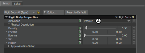

  3. Select the first bead and drag a Rigid body Physical Property on top of it.
  4. In the Physical Properties Setup pane, the Activation type to Passive.
    Setup pane A. Passive option

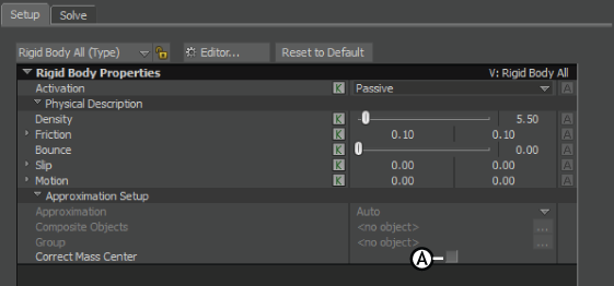

  6. In the Setup pane, expand Approximation Setup and deactivate the Correct Mass Center option.
    Setup pane A. Correct Mass Center option

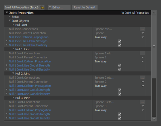

  7. Select the nulls between the beads and drag a Joint Physical Property on top of them. Click Joints in the Scene browser to display the Joint properties in the Navigator window.
  8. Ctrl-click the top bead and then the second one to select them. Alt-drag them in the Null Joint Connections field.
  9. Repeat this for all the other beads, for example bead 2 and bead 3, bead 3 and bead 4, and so on.
    The Setup pane Null Joint settings.
  10. You should select the parent first and then the child nodes.
    The Parent/Child order in a joint relationship is important as it defines how much reaction is carried through the chain. The Parent/Child relationships can also define the number of objects connected to the parent. For example, one parent object can have many children that are linked to it by a joint, however you cannot have one child with many parents as this creates solve conflicts.
