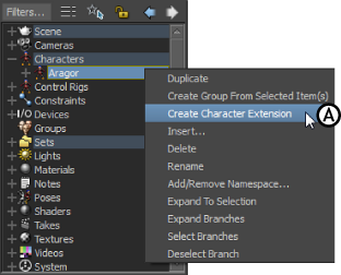

  1. In the Scene browser, right-click a characterized character and select Create Character Extension.
Scene browser A. Create Character Extension option
A Character Extensions heading is added to the Scene browser. By default, the Character Extension object added is named ** Extension, where ** is the name of your character.
Scene browser A. Character Extension is added to the character B. Character Extensions heading is added to the Scene browser

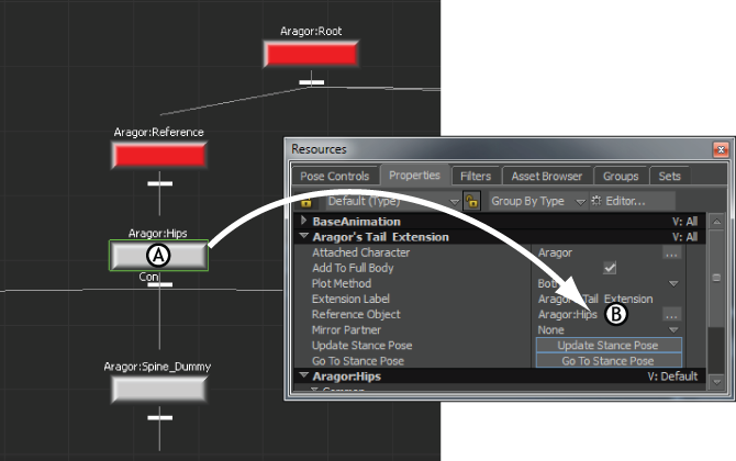

  1. Create a Reference Object for this Character Extension by doing the following:
  • Select the closest part of the body that affects the movement of your Character Extension. Normally, this is the direct parent of the Extension, but it can be any object associated with the Extension.
For example, if you are adding a tail, you might select the Hips bone, because you want the tail to be attached at the hips.
  • Alt-drag the selected body part into the Character Extension’s Reference Object field in the Properties window.
A. Selected bone to be associated with the Character Extension B. Reference Object property
This creates a Reference for your Character Extension, which is used to calculate all future positioning of the Extension, for example if the Character Extension is included in a pose.
