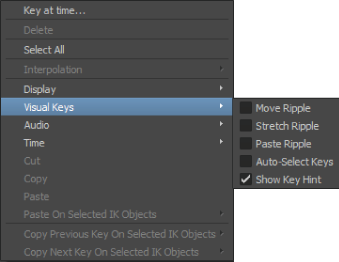

Visual Keys
The options in the Visual Keys menu let you set options for visual keyframes on the Dopesheet timeline and the Action timeline.

Option Description
Move Ripple Pushes deselected keys horizontally when offsetting a keyframe or keyframe region. Disable to keep deselected keys anchored when offsetting (default).
Stretch Ripple Moves deselected keys horizontally according to the stretch when stretching a keyframe region. Disable to keep deselected keys anchored when stretching (default).
Paste Ripple Moves deselected keys horizontally when pasting keyframe regions. Disable to keep deselected keys anchored when pasting (default).
Auto-Select Keys When activated, visual keyframes closest to the current timecode are automatically selected.
Show Key Hint When activated, certain keyframes display with color. Keyframes set in the Full Body character keying mode display with a red tip. Keyframes set in the Body Part character keying mode display with a green tip. Keyframes set in the Selection character keying mode do not have a color. See Keyframing a Control rig. When disabled, all keyframes look the same, except for keyframes set in the Story window.

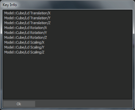

Key Info
When you right-click a keyframe, the Key Info option displays in the context menu, letting you open a Key Info window. The Key Info window displays information about the selected keyframe.
