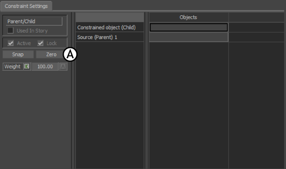

To lock the position of a constrained object:
  1. In the constraints setting for the appropriate constraint, make sure the constraint is activated.
  2. Activate the Lock option. This locks the position or rotation of the constrained object.
    Parent/Child constraint A Lock option
To reposition locked objects:
  1. Disable the constraint’s Active and Lock options.
  2. Transform the object and click Snap
  3. Activate the lock Option.
