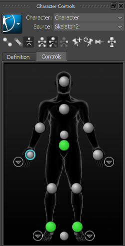

  3. In the Character Controls window, on the Character representation, select the Right Wrist effector.
    Character representation Right Wrist effector selected
    An effector that is selected is displayed with a blue ( ) contour.

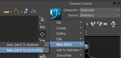

  6. From the Character Controls menu button, select Bake (Plot) Bake (plot) To Control Rig.
    The Control rig is plotted to Pepe's character.
    The Bake (plot) to Control Rig command creates a key at every frame at the base ( BaseAnimation) layer of the animation track, making edits difficult. (You can see these keyframes in the Transport Controls if you select Pepe’s wrist effector.)

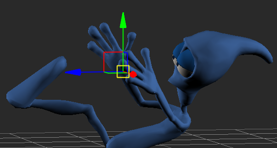

  14. In the Viewer window, move the right hand away from Pepe's face on its X and Z axes as shown in the following figure, then set another key.

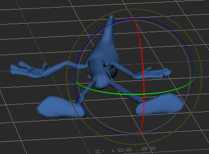

  20. In the Viewer window toolbar to the right, click the Rotate tool ( ) or press R to enable rotation.
  21. Modify Pepe’s right hand rotation until it rests flat on the ground, then set another key.
  22. Press R to use the key rotation rings to modify the hand’s position until it rests flat on the ground, then set another key.
