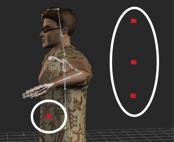

A pole vector is a constraint that makes an object follow the position of an object, or the average position of several objects. When you assign multiple objects as Pole Vector objects, the vector is drawn from a calculation of the Pole objects’ average position, as illustrated in the following figure.
The Character’s elbow position is derived from four markers.
