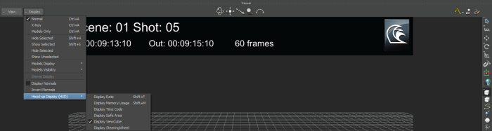

Legacy HUDs in the Display menu
In addition to the HUD elements in the Heads Up Display Entry dialog box, there are six legacy elements in the Viewer > Display > Head-up Display (HUD) menu.
Note: When you select a legacy HUD element from the Display menu, it displays the intended information in the scene and does not appear under the HUD asset in the Navigator window. Therefore, the HUD elements in the Display menu do not contain any properties to position, scale, or change the font and their color.
See:
- Display menu for Display Rate, Display Memory Usage, Display Time Code, and Display Safe Area
