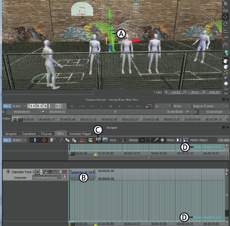

    For example, in the following figure, an animation character is selected.
  2. From the Story toolbar, click the Filter by selection icon.
    Viewer window and Story window A. Selected character B. Animation track for the selected character C. Filtering by selection icon D. Message to inform that only the track for the selected object is displayed
    According to your needs, manipulate the timing of the selected character.
