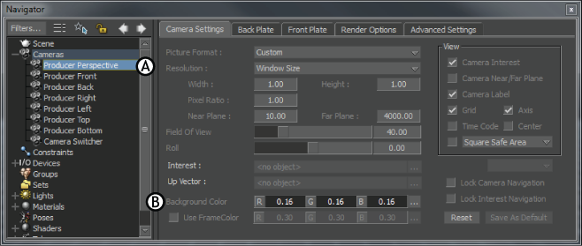

To change the background color:
In the Scene browser, double-click on the current camera to view its settings.
In the Camera Settings pane, use the Background Color settings to change the color.
Navigator window A. Current camera selected in Scene browser B. Background Color settings in Camera Settings pane

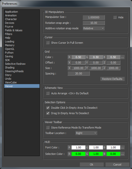

To change the grid color:
From the menu bar, select Settings > Preferences.
In the Preferences window, click the Viewer preference option.
Viewer preference settings
Change the grid color using the Grid Color settings.
