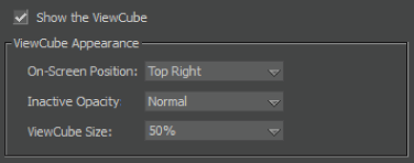

    To show or hide the ViewCube in the Viewer window:
    1. Right-click the ViewCube and select Properties from the context menu that appears.
    2. Deactivate the Show the ViewCube option.
      ViewCube preferences
    3. Click OK.
