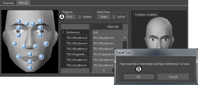

In the Regions area of the MoCap pane, click the Find button, then click Ok in the dialog box that appears reminding you that the face must be in the rest pose and facing the Z-axis.
Defining facial regions. A. Click Find. B. Click Ok.

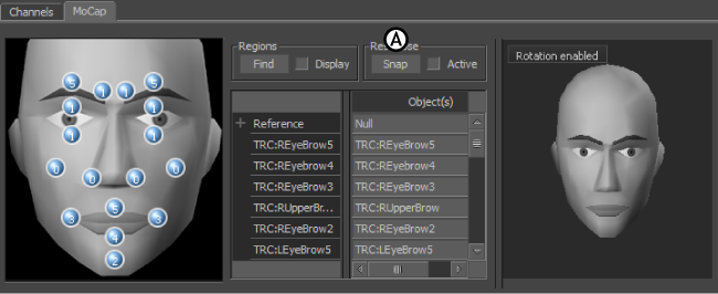

With the motion data in a neutral pose, click Snap in the Rest Pose area.
Actor Face settings A. Snap option
Click Ok in the dialog box that appears.
Facial Tool dialog box
The starting pose of the face is set, and the mapping is activated. The Active option is automatically enabled, and the other options in the Regions and Rest Pose areas are disabled. To make any changes to the mapping, you must disable Active.

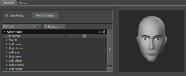

Switch to the Channels pane to verify that the Use MoCap option is be active.
The Use MoCap option is activated in the Channels pane.
The motion capture source can now drive the channels. When you play the animation, the channel sliders move and show their active values, and the Preview pane shows the effect of the motion capture data.
