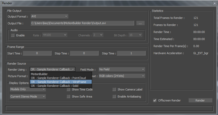

MotionBuilder uses the same render for both viewport display and file rendering. However, you can adjust various settings to achieve better quality in offline rendering.

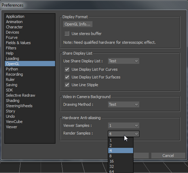

You can choose different hardware anti-aliasing sample counts for viewport and file rendering as shown in the following figure.

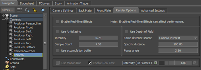

You can achieve advanced offline rendering effects either through multi-pass or super sampling techniques.
The offline rendering interface is updated. You can select the custom renderer and its preset, if available in the Render Using drop-down list for rendering an image sequence or video format. This can also be done using the SDK.
