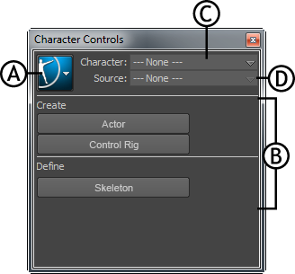

The following figure shows the Character Controls window, in the default mode.
Character Controls window A. Character Controls menu button B. Start pane C. Character menu D. Source menu
Start pane
The buttons in this pane help you to quickly begin the character setup process. For example, defining a skeleton, creating a HumanIK skeleton, or importing a motion capture example into a scene.

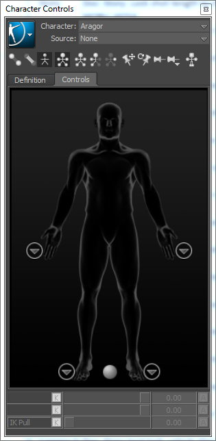

When you drag and drop the Actor or Character asset from the Resources > Asset Browser > Templates > Characters folder into the Viewer, the Character Controls window appears as shown below:
With the Character asset

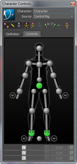

When you load a character that contains a Control rig, the Character Controls window appears as shown below:
