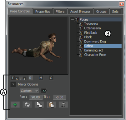

The Pose browser displays all the poses available for pasting onto selected characters. It is also where you create, update, and delete poses.
Pose Controls window A. Match and Pose options B. Pose browser
By default, there is one folder in the Pose browser named Poses. You can create folders (see Pose context menus), and organize your poses by dragging poses and folders onto one another.
You can also save selected poses and build a library of poses for pasting onto characters when needed. All the poses in the Pose browser also appear in the Poses group in the Scene browser of the Navigator window.

You can select poses to save using only the Scene browser.
