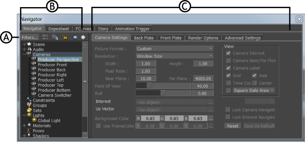

The Navigator window lets you view the hierarchy of your scene, search for character elements and objects in your scene, view relationships between assets, and edit the settings of an asset.
The Navigator window contains:
- Scene browser View options — Displays options that you can perform on a selected asset
- Scene Browser — Lists all the assets added to your scene
- Asset Settings — Displays the settings of the selected asset
Navigator window A. View options B. Scene Browser C. Asset Settings area
You can add many Navigators, Scene Browsers, and Asset Settings windows to MotionBuilder from the Window menu.
