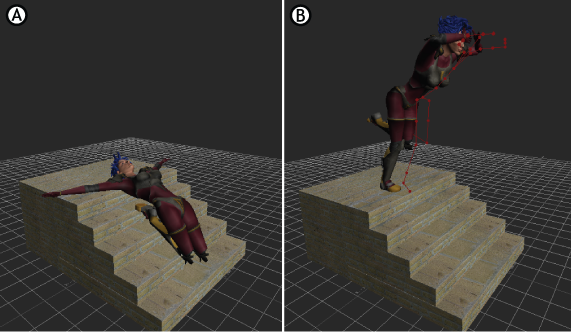

You can use character poses in a Ragdoll solve so you can define how a character collapses or falls. Using poses in this way is useful if you want to create a specific reaction or impression.
Ragdoll solves A. Without pose B. With pose (shown in red)

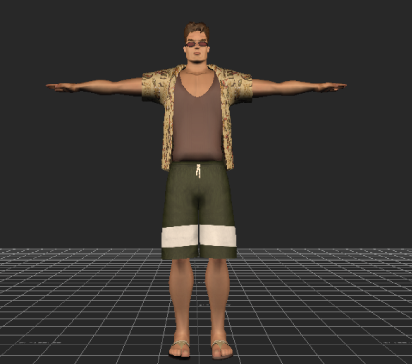

  2. Make sure that your character is in a stance.
    See Stance.
    Character in a stance

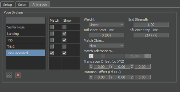

  3. Switch to the Ragdoll Animation pane and use the Add/Remove poses button to include your poses in the Pose system list.
    The Ragdoll Animation pane

    Avoid adding poses to the Pose list that you do not plan to use in the solve. All poses in the Pose list are used to derive the solve. Or to exclude a pose from the solve, set the Strength or Match Tolerance to 0.
  4. Activate the corresponding option in the Match column if you want to create a Match pose. Leave the option disabled if you want to set a Guide pose. Choosing a Match or Guide type of pose so lets you specify how you want to achieve the solve.

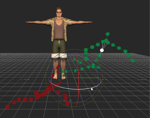

  5. Activate the Show option in the Pose list to view the Pose ghosts in your scene. You can select the ghost and position it in your scene until is it where you want it.
    Select a Pose ghost joint and transform it.
  6. In the Pose settings, specify a weighing type from the Weight menu.
    See Weight for a description of the different types of weighing available.
    Note:
    The Weight menu is set to Linear by default. Using the Linear setting is a good place to start for your first solve. You can then fine-tune the Interpolation types later.
  7. If you specified a Match pose, use the Match Object menu menu to set off which body part the pose match should be driven. The Match pose becomes the driving force of the solve.
    If you specified a Guide pose, use the Match Tolerance slider to how little or how much you want the Guide pose to influence the solve. The Guide pose suggests which way the solve is driven without forcing the solve to match the pose exactly.

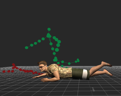

    Pose solve result
    Observe the solve and note the areas for improvement, if any. Pose Ghosts “light up” when they become active during the solve, so that a green Guide pose becomes a brighter green, and a red Match pose becomes a brighter red.
