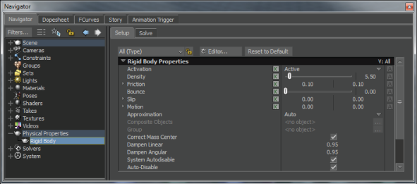

  5. In the Navigator window Scene browser, expand the Physical Properties folder and double-click the Rigid Body Physical property.
  6. Adjust the properties in the Rigid Body Setup pane (for example, Density, Friction, and so on).

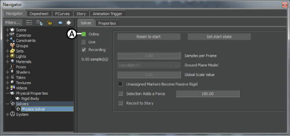

  7. Switch to the Navigator window > Solvers > Physics Solver pane, and click Online. Or you can also click the Active option in the Physics Solver properties in the Properties window.
    Physics solver Setup pane A. Click Online.
    The collision solving is now active and you can test and tweak your scene. See Rigid Body settings for information on the different settings.
