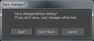

  1. From the menu bar, choose File New.
    The Save changes dialog appears.
  2. Click Don't Save if you saved the current scene in the previous procedure.

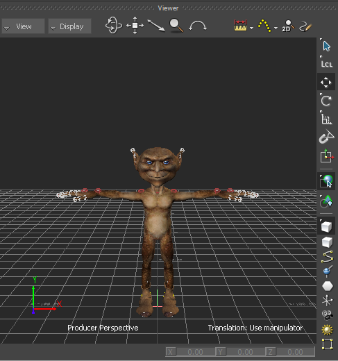

  4. In the Asset browser display pane, click the Gremlin asset (Gremlin.fbx file) and drag the asset in the Viewer window.
    The FBX Open context menu displays.
  5. Select FBX Open No Animation.
    In the Viewer window, the Gremlin character appears in the scene in the T-stance.
    Gremlin character in the T-stance
