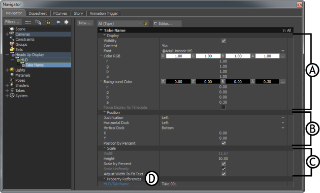

The properties of HUD element are useful to modify the appearance, position, and size of the content it displays in the Viewer. When you click a HUD element under a HUD asset, the element properties appear in the right pane of the Navigator window.
The HUD element properties are organized into four categories.
A. Display B. Position C. Scale D. Property References
  • Display — To modify the appearance of an element
  • Position — To change the position of an element in the scene
  • Scale — To increase or decrease the size of an element, along the X and Y axis
  • Property References — Displays the property name, which is referred by the HUD element to display the property value in the Viewer. For example, to display the current take name, the TakeName HUD element refers the value (Take 001) in the HUD.TakeName property.

The following tables explain each property within the Display, Position, and Scale category:
Display PropertiesDescription
VisibilityTo control the visibility of a HUD element content in the Viewer.
By default, this property is turned on for all HUD elements.
Turn off the checkbox to hide the content in the Viewer.
ContentTo enter the text that you want to display.
For dynamic elements, enter text before or after the variable %s or %d.
FontTo choose a font in which the text or dynamic content should appear.
The default font is Arial.
Color RGBTo increase or decrease the visibility of the HUD element content and change the font color.
The default color of the content is white.
Background ColorTo increase or decrease the visibility of the HUD element content background and change the background color.
Background for the content is visible, only if the value of A, in this property, is more than 0.
The dimensions of the background are directly proportional to the scaling of the content.
r, g, b, a
The r, g, b, a sub-properties are functionally similar to the R, G, B, and A color boxes in the Color RGB and Background Color properties.
Force Display As TimecodeTo forcefully change the format of a HUD element content from Frames to Timecode.
This property is enabled only for the EditTime and ActionTime HUD elements.

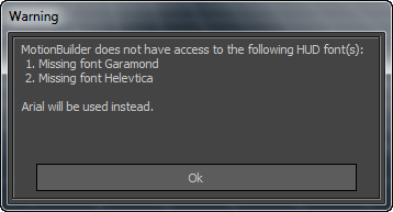

Consider that you create a scene in MotionBuilder installed on the Microsoft Windows operating system. The scene contains many HUD Text elements, each using different font (Garamond, Helevtica, and so on). Save the scene, and then load it using MotionBuilder installed on the UNIX operating system. If the UNIX operating system does not contain one or more fonts used in the scene file, then the following Warning dialog box appears.
This dialog box lists the fonts that are unavailable and informs which font is used, instead. At first, MotionBuilder checks for the availability of the (default) Arial font. If the Arial font is not available, then it checks for the availability of the following fonts in the given order and uses them if available:
  1. Helevtica
  2. Sans
  3. FreeSans
If none of the four fonts (Arial, Helevtica, Sans, and FreeSans) are available, then the first font that appears in the HUD Text element font list is used.
