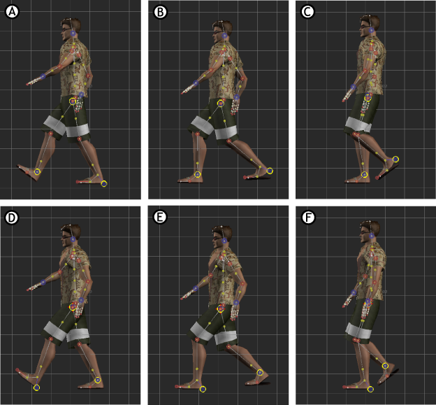

For example, in the following illustration, six keyframes were set on different positions of a character in a walk cycle. Playing the animation gives the impression of a continuous walking motion because of the interpolation.
Poses in a keyframe animation cycle A. Frame 0 B. Frame 5 C. Frame 10 D. Frame 15 E. Frame 20 F. Frame 25

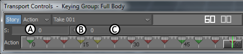

When Show Key Hint is active in the Transport Controls, keyframes set in Body Part Keying mode display with a green tip, keyframes set in Full Body mode display with a red tip, and when a Character Extension is keyed, the keyframe displays with a yellow tip. See Keyframing a Control rig for more information.
Transport Controls A. Body Part keyframe B. Character Extension keyframe C. Full Body keyframe
