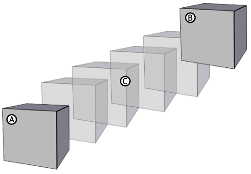

For example, the following illustration shows the interpolation of a simple animation that starts with only two keyframes. The first keyframe marks the cube’s position at the beginning of the animation, and the second keyframe marks the location of the cube at the end of the animation.
The computer program adds the additional frames between the two keyframes to provide the illusion of smooth, continuous motion when the animation plays.
Simple animation A. Keyframe on frame 0 B. Keyframe on frame 10 C. Interpolation adding frames between the keyframes
