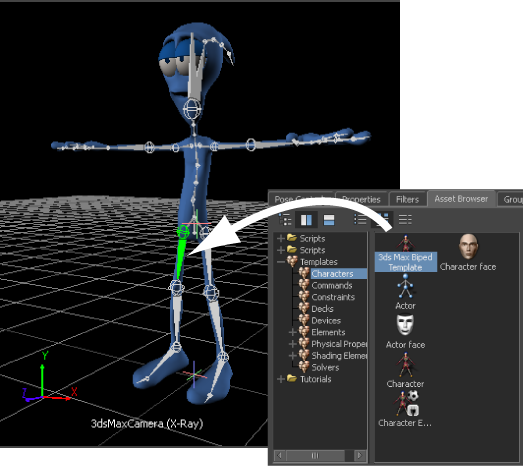

In the Asset browser, expand Templates > Characters and drag the 3ds Max Biped Template asset on top of the your Character skeleton.
3ds Max Biped Template asset applied to the Character skeleton
The 3ds Max Biped template is specially designed for bipeds created in 3ds Max as they have a different naming structure that the MotionBuilder Character does not recognize automatically.
Click Characterize in the menu that appears.

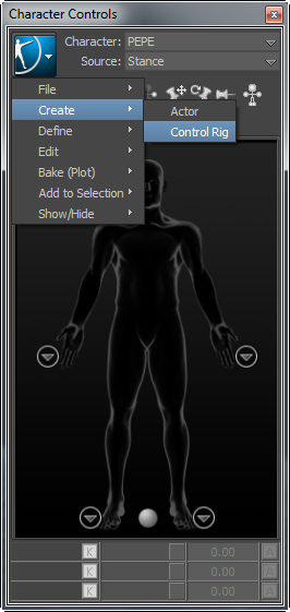

From the Character Controls menu button, select File > Create > Control Rig.
You must use the Control Rig Input setting if you intend use keyframe animation on your biped.
In the Create Control Rig dialog box, click FK/IK.

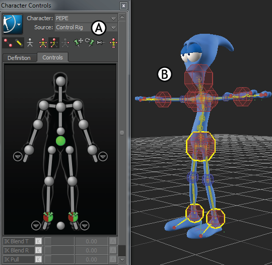

From the Character Controls window > Source drop-down list, select Ctrl Rig In (A).
Effectors appear on the biped as shown in the following figure (B).
A. Ctrl Rig selected B. Effectors appear on the character
The Character representation is a human form, meant to represent the character’s skeleton. It displays all the effectors you need to animate the biped's Control rig. The biped is now rigged and ready to receive animation.

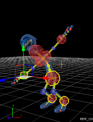

Translate (or move) the hand down as shown in the following figure.
As you move the hand, the arm extends and the rest of the body follows in a natural movement.
