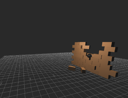

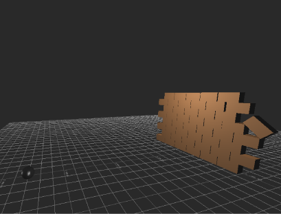

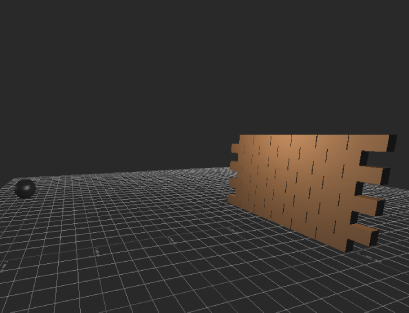

Sometimes you might want to animate collisions between more than one object. In this example, a cannonball is animated destroying a brick wall.
  1. Open a file with elements you want to animate.
  2. Create the animation you want to create the collision effect. In this example, the cannonball is keyframed to pass through the wall.

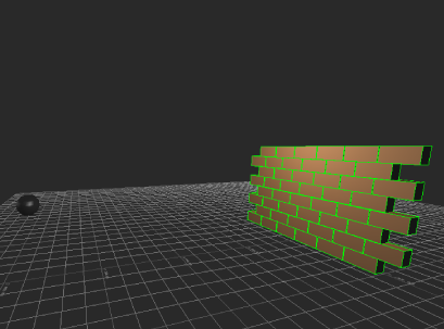

  3. Select all the objects you want to affect with the collision.
  4. In the Asset browser, expand Physical Properties and drag a Rigid Body Physical property onto the wall.
  5. Drop another Rigid Body Physical property onto the cannonball.

  9. Press Play in the Transport controls to view your results. Adjust both objects Rigid Body settings.
