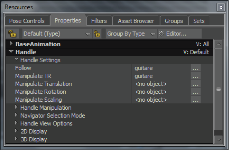

Handle properties
The following settings appear in the Properties window when a Handle is selected in the Scene browser:
Follow
Contains the names of the objects designated to lead the Manipulate object. The Follow object is used as a reference point for the Handle as well as a pivot point for Manipulate objects.
The Follow object is not transformed if it is not assigned to any Manipulate fields. See About Handles.
Note:
When you select a handle, the Follow object is considered the only “selected object” within the handle.
Manipulate TR
Assign the object(s) that you want to be manipulated in both Translation and Rotation mode to this field.
Manipulate Translation
Assign any Manipulate object(s) whose translation you want the Handle to influence to this field.
Manipulate Rotation
Assign any Manipulate object(s) whose rotation you want the Handle to influence to this field.
Manipulate Scaling
Assign any Manipulate object(s) whose scaling you want the Handle to influence to this field.

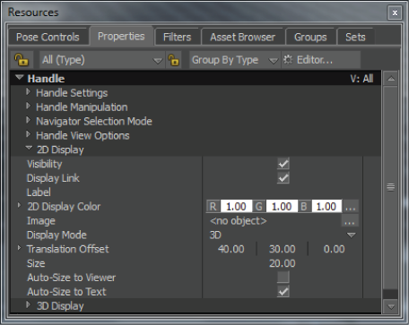

2D Display properties
The 2D display settings let you customize the look of the 2D Handle and the Handle’s knob so you can easily identify and select it.

Visibility
Deactivate the Visibility option to hide the 2D Handle.

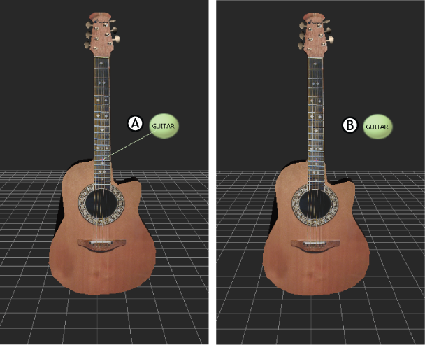

Lets you show or hide the line that displays between the Handle knob and the Follow object.
Show Link option A. The Show Link option is active. B. Show Link is disabled.

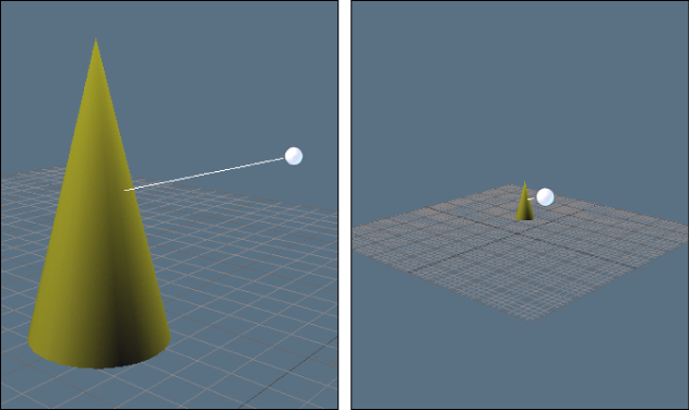

Display Mode menu
Lets you choose how the 2D Handle knob is shown in the Viewer window.
There are two options:
2D
Always the same XY distance from the object, relative to the Viewer.
3D
Always the same XYZ distance from the object, relative to the 3D world of the scene.
Translation Offset
Lets you modify the X, Y and Z distance of the 2D Handle from the Follow object.
Size
Increase or decrease the size of the Handle knob so you can select it easily.
Auto-Size to Viewer
Activate to make the Handle a consistent size Label text, no matter how far away you get from it.
Activate Autosize to Viewer to make the handle the same size no matter how close you zoom in.

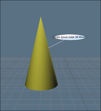

Auto-Size to Text
Activate to make the 2D Handle accommodate the label text (Label field), regardless of the Handle size or camera distance.
Using Auto-Scale to Text, the handle accommodates any text entered in the Label field
