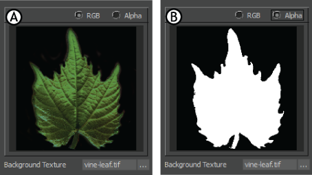

  4. In the Texture settings, select New Media from the Media menu to open a file browser which lets you select the image to be used as the camera’s Front or Back plane.
    You can also use a video clip to project on the foreground/background plane. The new image or video clip is added to the Video folder in the Scene browser.
  5. Select either the RGB or Alpha options to preview either the RGB or Alpha channels of the loaded image.
    Image preview A. RGB view B. Alpha view
