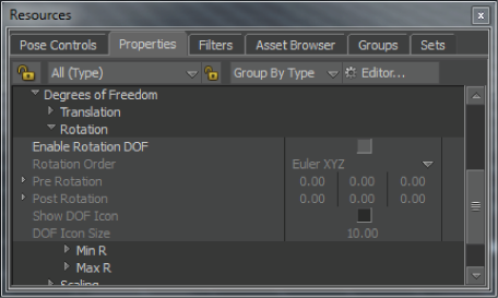

Degrees of Freedom Rotation properties
Enable Rotation DOF
This option lets you activate or disable the DOF rotation properties. When DOF rotation properties are disabled, the Min R and Max R values are ignored and the object can rotate in any direction. When DOF Rotation properties are active, a wireframe sphere displays on the selected object.

Pre Rotation
These values let you offset the rotation sphere orientation before the limits on rotation are calculated. As you adjust the values in these fields, the rotation sphere in the Viewer window gives you visual feedback.
Post Rotation
This option lets you offset the rotation pivot orientation after the limits on rotation are calculated. As you adjust the Post Rotation values, the rotation sphere in the Viewer window gives you visual feedback.

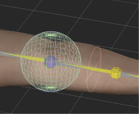

Show DOF Icon
Shows or hides the DOF rotational sphere.
The DOF rotation sphere displays on the selected object in the Viewer window, giving you visual feedback on the limits on rotation you have set, and identifying which is the roll axis for the selected bone.
DOF Rotation sphere displays on the LeftForeArm bone
DOF Icon Size
Defines the size of the DOF rotational sphere that appears in the Viewer window to visually represent the rotational DOF properties. The default size is 10.
Min R
Contains a set of check boxes and fields that let you enable, disable, and define the minimum rotation values allowed per axis for the selected object. The following table describes the options found in the Min R group of properties.
OptionDescription
Enable Min X, Y, ZActivate and disable the limits on rotation specified for each axis in the Min Freedom fields.
Min FreedomSpecifies the minimum value the selected object can rotate to on each individual axis. If an object attempts to rotate past these values, its rotation clamps to the minimum value.
Max R
Contains options that let you activate, disable, and define the maximum rotation values allowed per axis for the selected object. The following table illustrates the options found in the Max R group of properties.
OptionDescription
Enable Max X, Y, ZActivate and disable the limits on rotation specified for each axis in the Max Freedom fields.
Max FreedomSpecifies the maximum values the selected object can rotate to on each individual axis. If an object attempts to rotate past any of these limits, its rotation clamps to the maximum value.
