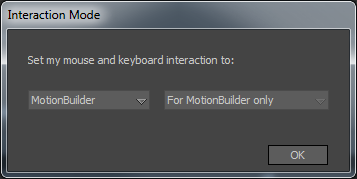

The Interaction Mode lets you to quickly choose the keyboard shortcut set to use within MotionBuilder, and for all products within the Suite if applicable. By default, the interaction mode is set to the product currently launched.
When you first launch MotionBuilder, the Interaction Mode window displays, enabling you to specify a keyboard set.
The options available depend on the software installed on your system and on whether the software installed on your system is part of a Suite license software product. For example, if you installed Maya as part of a Suite software product and are running the product using a suite license, you can also set whether you want to use the same set of keyboard shortcuts across all the products in your suite.

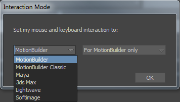

MotionBuilder has two sets of keyboard shortcuts (i.e. MotionBuilder and MotionBuilder Classic) as well as four sets of keyboard configurations that simulate the keyboard shortcuts from other popular 3D software applications.
For a list and description of keyboard shortcuts supported by MotionBuilder, see also:
- MotionBuilder keyboard shortcuts
- MotionBuilder Classic keyboard shortcuts
- 3ds Max keyboard shortcuts
- Maya keyboard shortcuts
- Softimage keyboard shortcuts
Launch MotionBuilder.
The Interaction Mode window displays.
Choose the interaction mode from the list of supported keyboard shortcut sets.
Click OK.
To subsequently change the interaction mode:
- From the menu bar, select Settings
Interaction Mode. - Choose the interaction mode from the list of supported keyboard shortcut sets.
When a custom keyboard configuration text file has been saved to the MotionBuilder
bin
config directory, the list of available items in MotionBuilder Interaction Mode setting menu shall update to include the name specified in the name field of the custom keyboard file.
