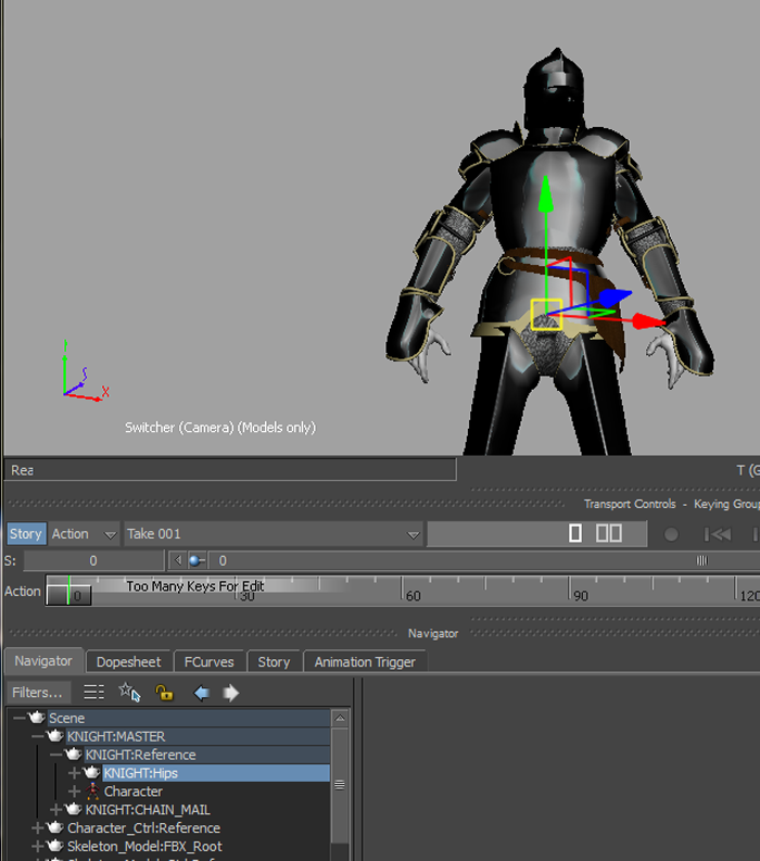

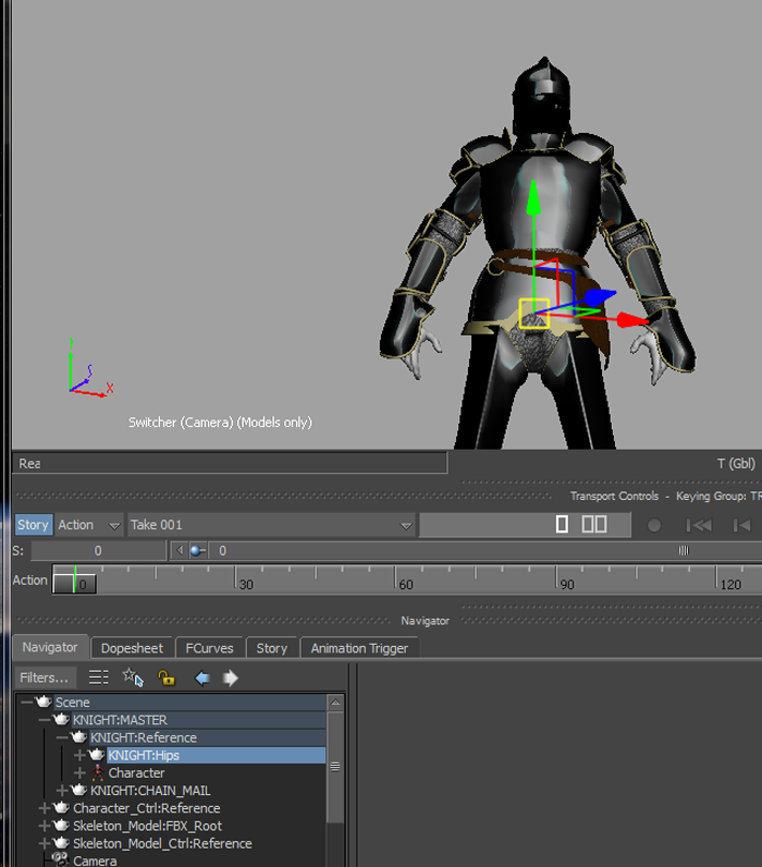

  1. Open the StoryExample.fbx in MotionBuilder.
  2. Select the skeleton hips in the Knight character. You can see that it does not contain any animation.
  3. Run the plot_animation_from_story_to_character.py script. It plots the animation from the story to the character’s skeleton. Now, you can see the animation in the character's hips.
