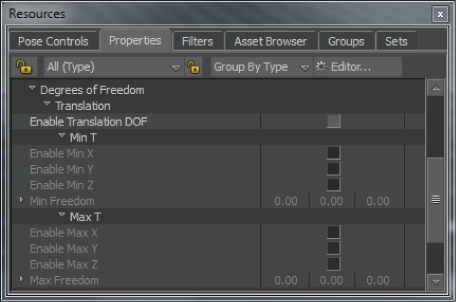

The DOF Translation properties let you restrict an object’s linear movement between a minimum and maximum translation value.
You can use these properties to limit the movement of various models and prevent them from coming into contact with each other.
Degrees of Freedom Translation properties
Enable Translation DOF
Activates the limits on translation specified for each axis in the Translation Min and Max fields. When DOF translation properties are disabled, the Min T and Max T values are ignored and the object can translate in any direction.
Min T
Contains options that let you activate, disable, and define the minimum limits on translation for each individual axis. The following table illustrates the options found in the Min T group of properties.
OptionDescription
Enable Min X, Y, ZActivate and disable the limits on translation specified for each axis in the Min Freedom fields.
Min FreedomSets the minimum translation values the selected object can occupy on each individual axis. If an object tries to move past these values, its translation is constrained by the DOF.
Max T
Contains properties that let you activate, disable, and define the maximum limits on translation for each individual axis. The following table illustrates the options found in the Max T group of properties.
OptionDescription
Enable Max X, Y, ZActivate and disable the limits on translation specified for each axis in the Max Freedom fields.
Max FreedomSpecifies the maximum translation value the selected object can occupy on each individual axis.
