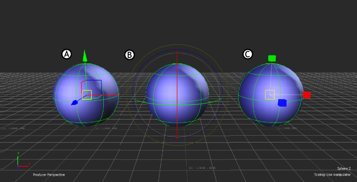

Transformation handles on a sphere A. Translation B. Rotation C. Scaling
