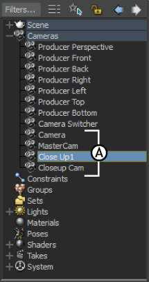

You can add an unlimited amount of cameras, by dragging a camera asset into the Viewer window. These Custom cameras can be manipulated, constrained and animated; they let you alter the settings to mimic real-world camera and film aspects. Once you add Custom cameras to a scene, they are listed below the Camera switcher in the Cameras folder.
Scene browser A. Custom cameras

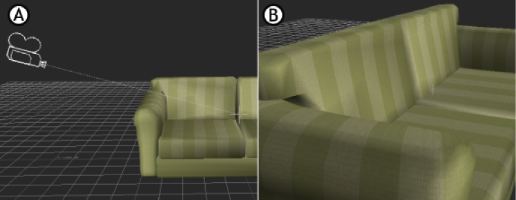

Custom cameras are shown in the Viewer window as white wireframe movie cameras. You can view your scene through these cameras, which can be translated, rotated, scaled, and animated.
Camera views A. A custom camera viewed through the Producer Perspective B. The custom camera view.
In certain viewing modes, as in the previous figure, you can see a dotted line that ends with a “+” (cross) symbol coming from the camera. The “+” (cross) symbol is the camera interest, or focal point, and the dotted line shows the camera view’s path.
