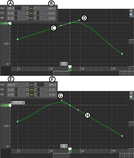

The Auto interpolation settings allow you to edit the angles of function curves parametrically, where the angle of left and right tangents are changed in relation to the previous or next keyframes.
The Auto settings consist of fields, Reset buttons, and a Link button.
Auto settings A. Value for left tangent B. Reset left tangent C. Link option D. Reset right tangent E. Value for right tangent
Auto (Aut) fields
The Auto settings include two fields (A and E in the figure above), which allow you to change the angles of left and right tangent, respectively, in a selected keyframe.
Editing tangent angles using Auto settings A. Left Auto field is set to 100 B. Right Auto field is set to -100 C. Left tangent points to the previous keyframe D. Right tangent points away from the previous keyframe E. Left Auto field is set to -100. F. Right Auto field is set to 100 G. Left tangent points away from the next keyframe H. Right tangent points to the next keyframe
When you modify the Auto settings, the tangents behave as described in the following table:
0At 0, the curve represents the average between the previous and next keyframes.
100When the left Auto field is at 100, the left tangent points to the previous keyframe (A and C in the figure above). When the right Auto field is at 100, the right tangent points to the next keyframe (F and H in the figure above).
-100When the left Auto field is at -100, the left tangent points away from the next keyframe (E and G in the figure above).When the right Auto field is at -100, the right tangent points away from the previous keyframe (B and D in the figure above).
