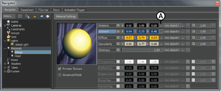

  1. Click the Color button in any window next to an option that lets you change the color of an object.
    For example, you can open the Color window from the Emissive, Ambient, Diffuse, or Specularity color areas of the Material settings pane by clicking the Color button.
    The Color window appears.
    Material Settings A. Color button
