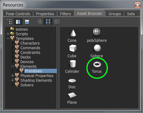

torus = FBCreateObject( 'Browsing/Templates/Elements/Primitives', 'Torus', 'Torus' )

Note: When you are a creating primitive element such as a torus or a sphere, the FBCreateObject() function requires that the third parameter be identical to the second parameter. The second parameter must also match the name of the primitive you wish to create from the asset browser (e.g. 'Torus').

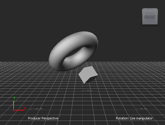

Example: Basic Model Organization
Sample Viewport Output:
Program Summary: The program below creates a cube and a torus, and assigns the torus as a child to the cube. The printSceneGraph() helper function recursively traverses and prints the scene graph.

# Print the scene graph.
printSceneGraph(scene.RootModel, 0)
# Output.                                                     #
#Scene - FBModel
#    myCube - FBModelCube
#        Torus - FBModel
