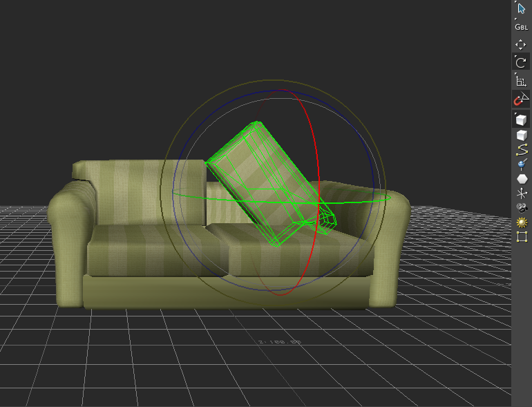

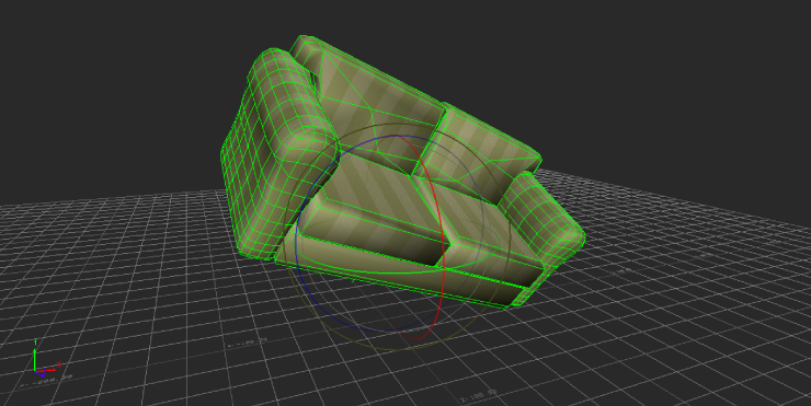

  3. Select the object’s rotation rings in the Viewer window and drag them or do one of the following:
    • Enter precise values in Properties windows.
    • Double-click a rotation ring and enter a value in the Axis Rotation Degree Delta dialog box that appears.
    Selected object in the Viewer window displays with Rotation rings for rotating on the X, Y, or Z axis

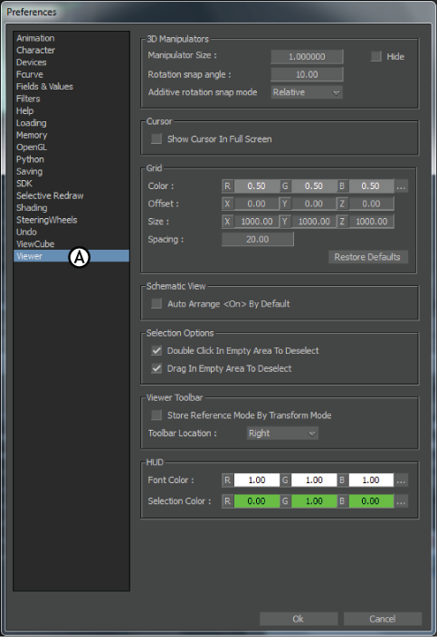

To snap the rotation of objects at specific increments:
  1. Select Settings > Preferences from the menu bar.
  2. In the Preferences window, select the Viewer preferences (A).
    Preferences window A. Viewer preferences
  3. In the 3D Manipulators area, enter the size of increment (in degrees) in the Rotation snap angle field.
