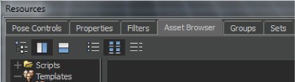

Default layouts contain windows with tabs that combine two or more windows in the same window. For example, the following figure combines the Pose Controls window, Properties window, Filters window, Asset browser, Groups window, and Sets window in the same location. To switch between windows, click on the appropriate tab.
Window with tabs
