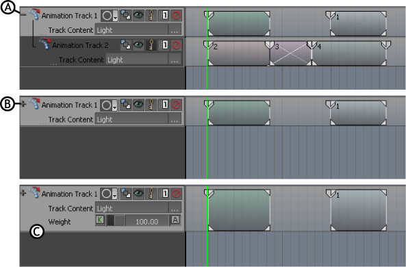

Collapse and Expand
You can expand and collapse folders and tracks when you have a hierarchy of folders, tracks, or subtracks.
To hide or show the selected track’s subtracks, click the Collapse/Expand (- +) button (A and B) located at the upper left of the Track controls. Collapse and expand tracks when you use multiple hierarchies of tracks, or do not want to view all tracks simultaneously. See Insert Subtrack for more information on creating track hierarchies.
You can also resize tracks vertically if you want to display additional options or a better view of a track’s audio waveform. To resize the track, drag the bottom of its Track controls up or down.
Tracks A. Collapse symbol B. Expand symbol C. Stretch track

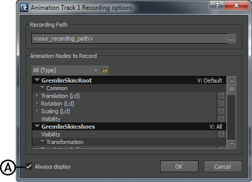

Record Mode button
When you click the Record Mode button (
) in the Story window > Generic, Character, or Camera Animation Track, the Animation Track Recording options window for that specific track appears. In this window, by default, the Always display checkbox is turned on. If you turn this checkbox off, then in your next session, you cannot invoke the Animation Track Recording options window by clicking the Record Mode button.
Animation Track Recording options window A. Always display checkbox turned on by default

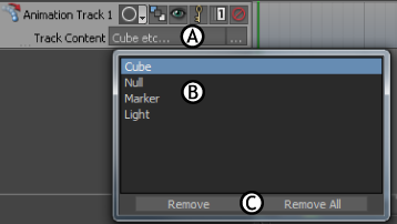

Track Content list
The Track Content list displays the name of the asset that you drag onto an Animation, Character, or Camera Animation track. A track’s clips affect the asset selected in the Track Content list. These selected assets are often referred to as the track content.
Clicking the Track Content list displays the entire list of assets you have dragged into the track. The Remove button lets you remove objects from the list.
Animation track A. Track Content list B. Click on the list to see what you dragged into the track. C. Remove button
The Track Content button displays the Asset list. This Asset list lets you select assets and create local blends.
Animation track A. Track Content button B. Asset list
