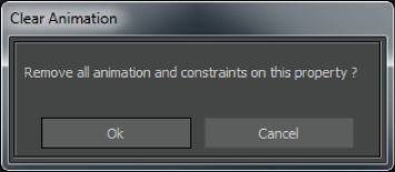

To remove animation from a Blend property, click the Animate (A) button and click Ok in the Clear Animation dialog box that appears.

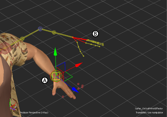

However, when you play your animation, the interpolation of the IK rig and the interpolation of the FK rig may not match, because each rig solves differently. Between keyframes, the IK rig and FK rig may not occupy the same space.
Between keyframes, the IK rig (A) and the FK rig (B) do not match since each rig uses a different method of solving.
The Blend T and Blend R sliders let you adjust the amount of influence each system (IK or FK) has on a body part when the two systems get out of sync. This gives you complete control of what happens between keyframes.

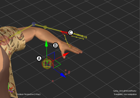

For example, in the picture below, a value of 30% is assigned to the Blend T (Translation blend). When the wrist effector of the character is translated, the model follows the FK rig more closely (A to B=70%, B to C= 30%).
A. Blue IK wrist effector is selected B. Character’s arm reaches towards the FK rig since the wrist effector’s IK translation blend is set to 30% C. Yellow FK rig

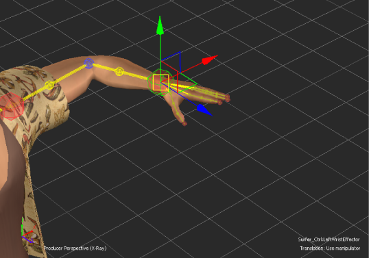

If the Blend T value was set to 50%, the skeleton appears between the FK and IK rigs. The solution of the IK rig and the FK rig is blended together equally to influence the body part.
