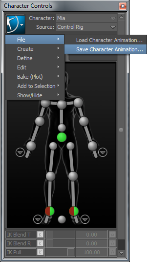

  1. In the Character Controls window, select the > File > Save Character Animation option.
    The Save File dialog box appears.

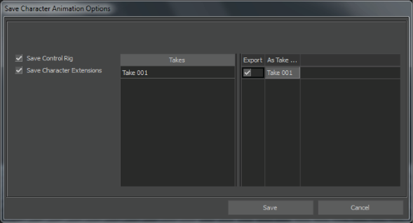

    The Save Character Animation Options dialog box appears.
  3. Select the options you want to use, and make sure the take you want to save is selected in the Takes list.
    For more information on these options, see File menu.
  4. Click Save.
    The character animation is saved as an .fbx file. Now that you saved character animation, you can transfer it to any character using the Load Character Animation option. See Loading poses for more information.
